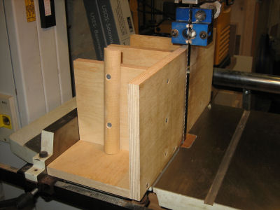

What are you cutting? What blade are you using?
I have cut hundreds of b/s and top sets. It's my "hobby". Sawing tonewoods is similar to other resawing, but the differences are mainly in the tolerences you end up working at. It depends on the board I'm working with, but I try and saw backs anywhere from .135" to .160". Sides generally around .115" to 125", often a little thinner. I've gone as thin as .100" for backs, but there is no room for error! I won't do that again.
Make sure your saw is running as well as possible. Use a sharp (ie. new) blade. I like to flatten after each pass on the saw. If everything is going smoothly and the board is behaving, I may joint my side billet every other pass, or not at all.
Make sure the boards aren't cupping or twisting as you remove material - which is often the case. I like to run my back billets (both surfaces) through the sander after each pass, so that I always have a flat, true surface to work with. Again, if everything is going well, I will relax this a little.
You can cut things fat and ignore the frequent flattening, but then you will end up spending a lot more time at the thickness sander later on. It's just a matter of style and preference. My technique may not make sense for a wood dealer, but it suits my building style just fine.
Don't get too greedy with those special boards! My tendency is to always try and maximize yield, and it doesn't always work out the way you hope. Trying to squeeze that extra set will sometimes backfire if the blade wanders or you encounter a problem. IMO, it's always better to have 5 good slices, instead of 6 crummy ones. The extra cut will save you if you encounter a defect in a slice, and otherwise will become headplates, bridge patches, etc.
As far as blades go, there are many discussions about that on the net. I like the Timberwolf 3/4" AS-S, but they don't last all that long in rosewood and ziricote. I was resharpening these for a while, but it is too time consuming. Now I just buy new ones - a lot of them. The Woodslicers work really well in woods like mahogany and will definitely increase your yield. For general use, I like my Laguna resaw King - which I believe is carbide. I also have the an older Timberwolf carbide and have tried the Lenox blades as well.
I have an older Euro-spec MM16, and it's a great saw. 12.5" of resaw, 3.5 HP, etc. Make sure everything is square and running true. Set your guides carefully. Make a tall sturdy resaw fence, don't over feed and when the blade starts to struggle - put on a new one. This saw will push a dull blade through just about anything, but you don't want to push your luck.

(1) Don't be greedy. I made myself very angry ruining a couple sets of very nice wood by going too thin early on. I have since decided that there is nothing wrong with getting 4 pieces of wood per inch. I spend a little extra time at the thickness sander, but I don't mind.
(2) I think you should buy or make a good fence and set it up properly. I've never tried the "pivot point" method of resawing, though. It's just hard to beat a good straight fence.

Brad, good idea to practice on something that isn't real valuable. Could be anything, really. Makes sense for both sawing and bending. The Trimaster will handle anything you can throw at it.
There may be sponsers who sell billets - but I don't know for sure. If you look online, checkout Gilmer, Cook Woods, eBay, etc. You're not far from Berea Hardwoods in Middleburg Heights. Probably worth a trip to see some nice stock in person. Lowes, Home Depot, Woodcraft, Rockler, and many lumber yards also carry exotics and many domestics that can be used for building.
It's handy to know the moisture content of your wood, but you can work without a moisture meter. I like to let boards acclimate as long as I can before sawing, but it isn't required. After sawing, you will likely need to sticker and stack them. Turning wet boards into dry sets can take some patience, finesse and care. My recommendation is to find some nice dry, well quartered mahogany, maple (or similar) and go for it. Keep it simple.
I occasionally use a point style fence, but only when I have a board that is too cupped or twisted to flatten easily. My preference is for a sturdy right angle design. Use whatever you feel comfortable with, but the tall fence gives me the best results. I run this against my rip fence, and clamp it to the table. It's about 8" tall and very square to the table.

Brad, I use a fence setup like Steve does but my fence ends just past the cutting edge of the saw. The reason is that if the wood has internal tensions it will bow or cup as it comes through the saw pushing the board away from the fence. I find this helps my thickness consistancy

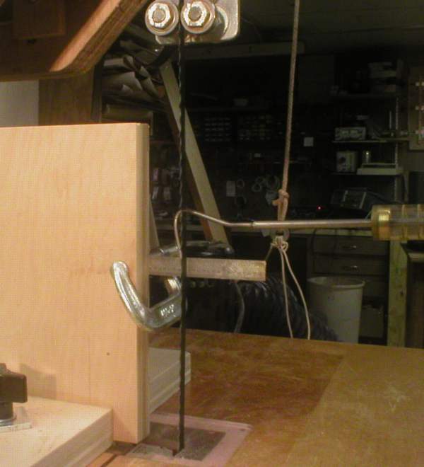

Here's an easy way to check your blade tension on the cheap:
First, set up the guides pretty far apart (for example, 10 inches; the further, the better).
Then, set up a ruler to measure the sideways deflection of the blade, and pull sideways on the blade with a spring scale with a few pounds.
By measuring the deflection (d), and knowing the spring scale force (F), and the height between guides ( h), you can calculate the tension (in pounds) :
T ( pounds) = ( F x h ) / ( d x 4)
Then, you can take the cross sectional area of the blade you are using A = ( thickness x width) and figure out the blade stress ( S) in psi :
S (blade stress in psi) = T / A
For the width of the blade, you should use the width to the bottom of the tooth gullet, which will be a little less than the total width.
You can tension your blades to 30,000 psi safely. I usually end up at about 20,000 psi, and that works fine for me.
If your saw can't tension the blade to at least 10,000 psi, you should probably switch to a narrower blade so that you tension it to a higher stress.

I forgot to mention in the last post (measuring bandsaw blade tension) that you should to set up the ruler (and pull with the spring scale) midway between the top and bottom guides. Otherwise you won't get the right answer.
